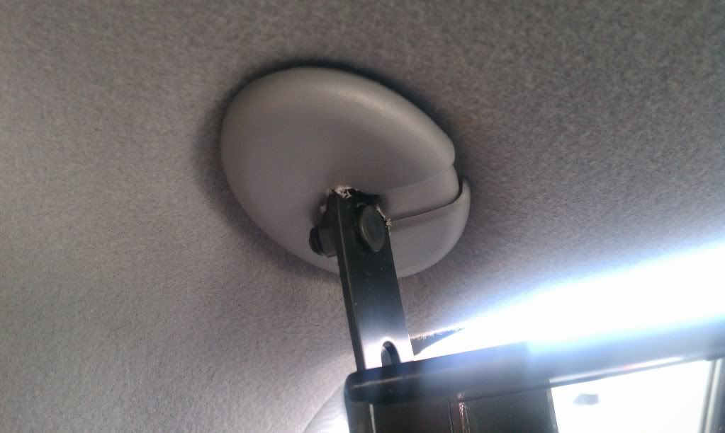

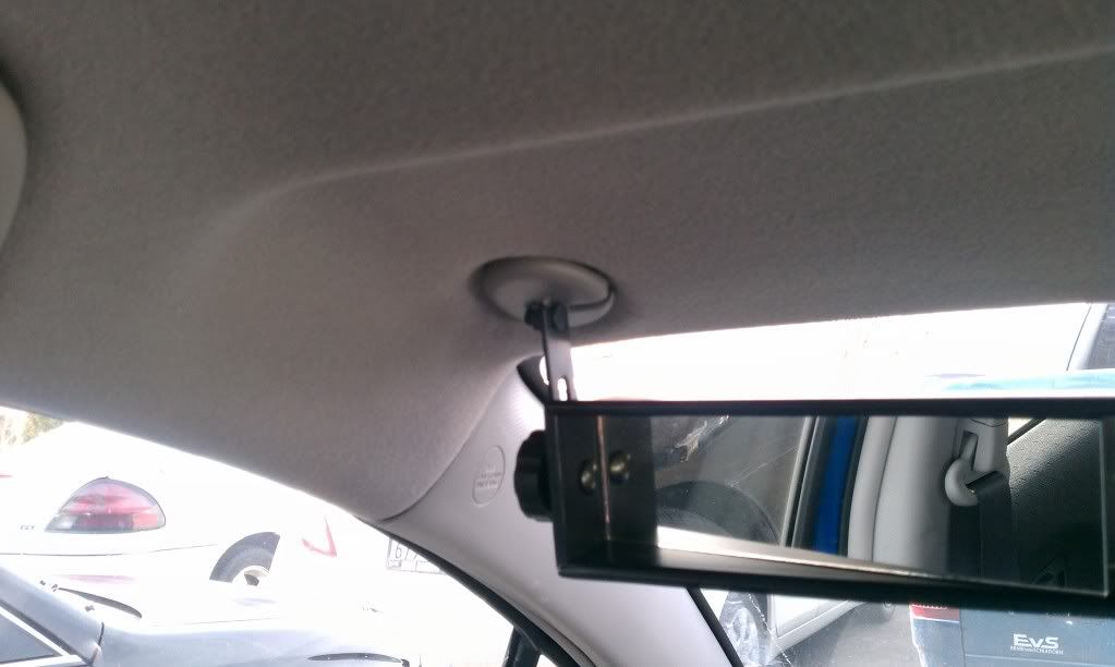

Here is how I mounted mine.
I used a dremel to cut the visor off the plastic mount. Then kept shaving away the plastic mount until the "L" bracket fit in it. It turned out nice. Very oem looking compared to seeing the sheetmetal.

Old 03-03-2011, 05:28 PM   #24
^ That's a lot cleaner than my install.

PK, it's a series of fixed, flat mirrors that give a wide field of view. I can even see out my front windows with it. Really helps eliminate the blind spot when you get used to it.
Yaristeve, no, all of those accessories clip/mount into metal underneath the headliner.

Posts: 92
On my civic I first used the glue on windshield mounts. They work alright. It uses a silicone based glue. It's a nightmare attaching them and making sure everything lines up. If you hit a bump hard enough, like most railroads, it flops down and you are looking at your lap. If you hit a really big bump it falls off. Use the visor way to install. Much more rigid and you don't get nearly as much vibration in it.

1 Completly remove your visors.
2.Use a dremel to cut off the visor mounts
3.Use a dremel to cut a slot for the wink brackets
4. Install the bracket onto your car (pain in the butt, because you have to press them in fully put together)
5. Install wink mirror onto brackets
Yes you ruin your stock visors, yes the brackets will probably never come out again with out totaly ruining them. But you will need to buy new visors to replace them anyways. I didn't use an screws or glue for attaching the brackets. The fit is so tight you don't need them. My mirror doesn't move at all. I have no pictures of the install.
