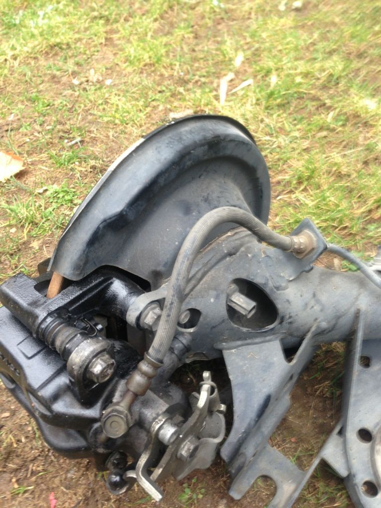

I'm having a hard time understanding how the OEM parts go together. The parts diagrams from Village Toyota include the SE, but they don't show a full assembly of the caliper and mounting bracket. The beams are very different, as well. Is there another part on a different diagram that I'm missing?

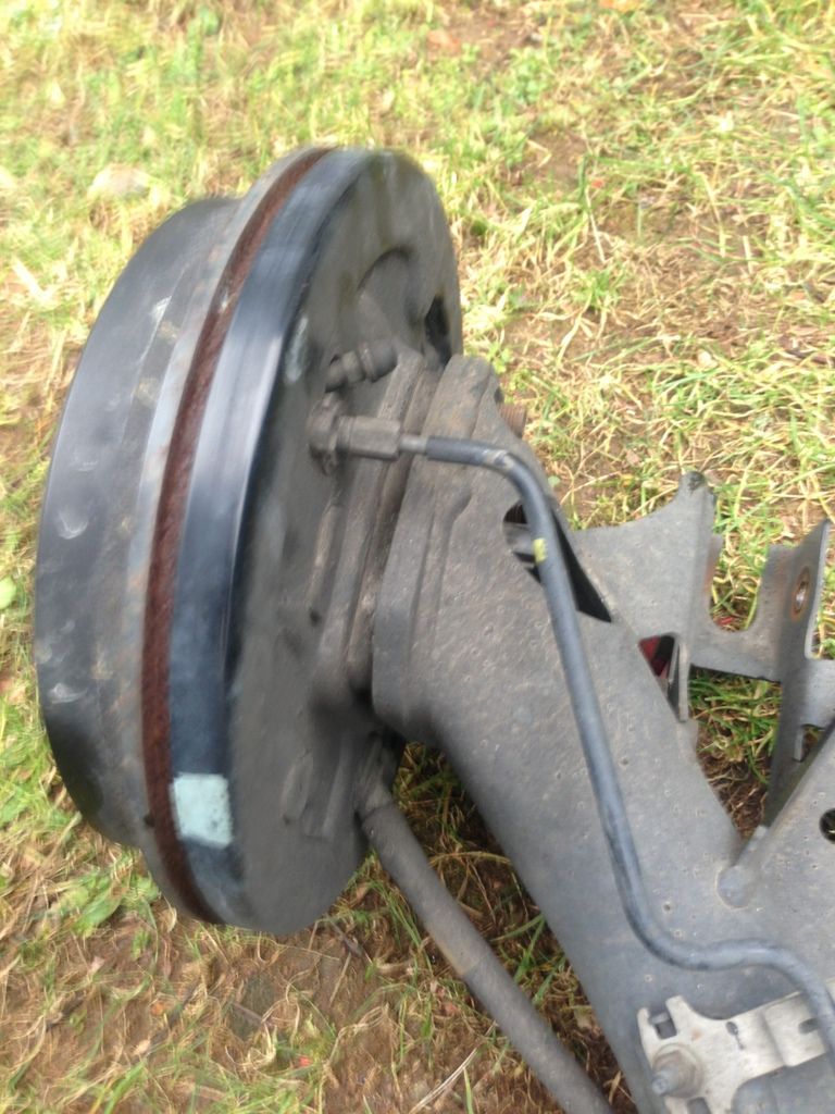

Those beams shown in that epc arent RS/SE beams...i checkd myself and it doesnt show the actual look.
i took pics when i got mine in comparison..
vs drum:

Aah, that makes much more sense! Was yours a JDM import?

good man! finally my idea is taking shape after yrs :) can you show the mount of the caliper to hub? can you get the ebrake cable from the car too? it really isnt hard to harvest it. it might be longer, but im sure you can cut it to size.
yes.
