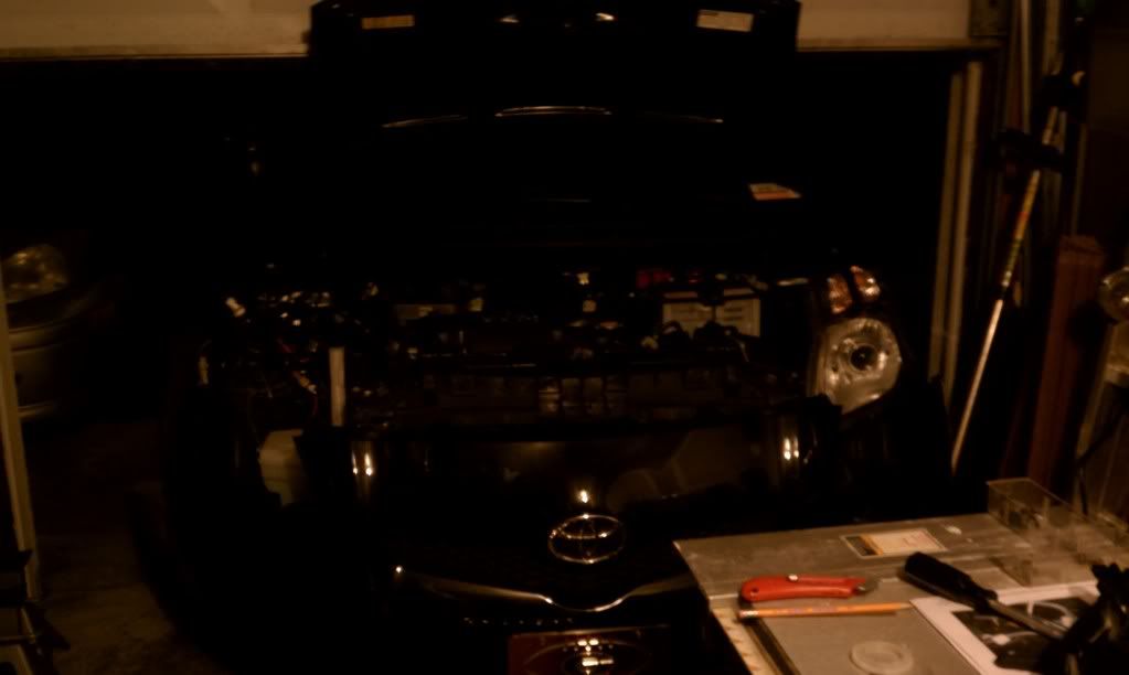

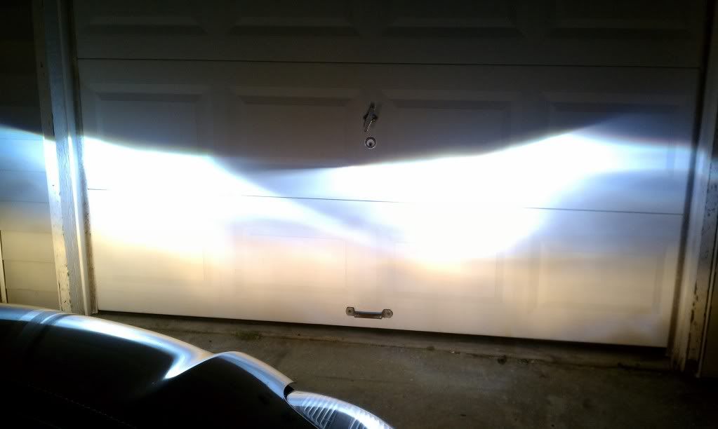

After 10 days in a row of working nights (gotta love pharmacy life and how many 'sick' people there are) I finally got some time after I got off work tonight to crack into these again and do some digging around.
My poor car all one-eye'd again. I'm sure he thought this poking him in the eyes thing was finally done with. lol

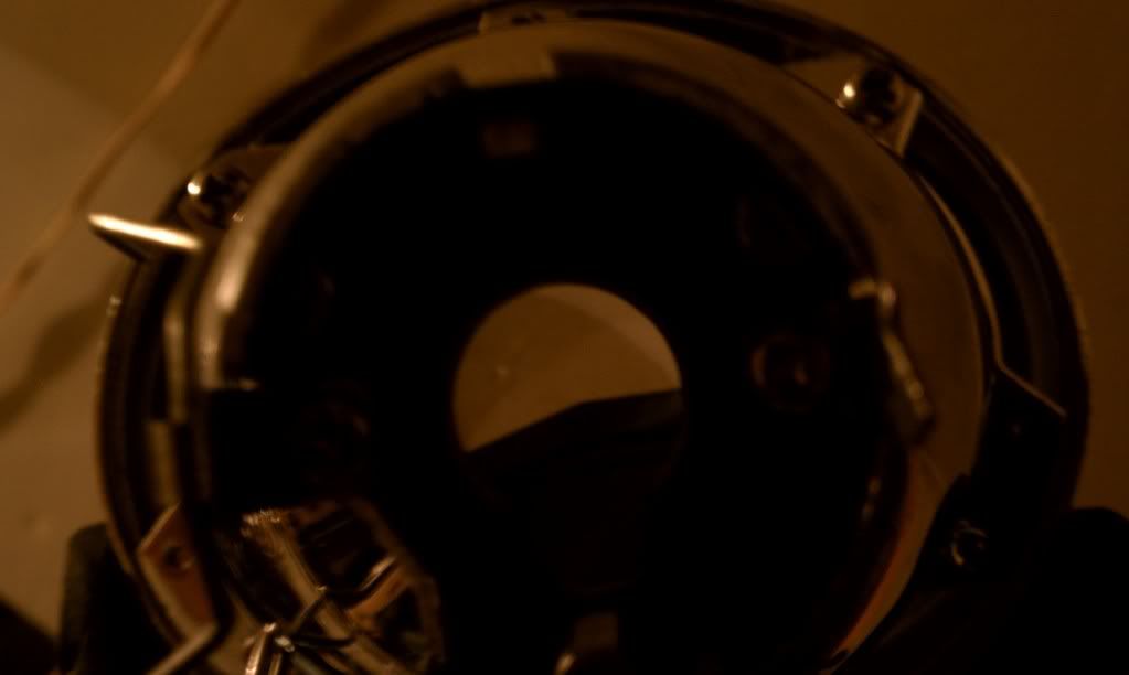

Took a projector out and this is the view through it.

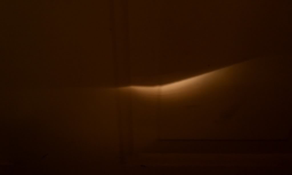

Remember, that everything you see in a projector is mirrored and upside down. With that in mind, the cutoff is correct and these are indeed LHD projectors. I shined a flashlight through it and pointed it at a wall with the 'top' marker as straight as possible and this was the result:
As you can see, the cut off is correct and kicks up to the right. So, not only did I install them incorrectly, I did so in such a perfect manner as to mimick RHD projectors. Essentially, the proper beam to be facing straight horizontal was kicking up to the left and the part that should kick up to the right was straight across. I guess this is me eating my crow, and my apologies to Garm/MI. I feel a little sheepish. lol

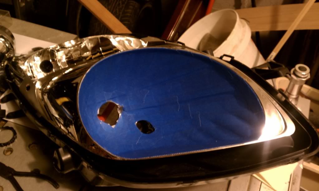

I'm still hesitant to paint the reflector bowls, mostly because now it is too cold to be painting (tonight, at least...it's about 35F out at the moment). I had to brew an idea up to see if I could get around the reflection of the light bouncing around in the bowl of the projector until it warms up enough to paint. Here is my solution for now:
It's not perfect, but I may just paint the tape itself and see how that goes before I go painting the whole thing. One other thing I noted is that it's been almost two weeks here on the Georgia beach with two nights of rain passing by. My lights have not been sealed this entire time. It's not exactly 0% humidity around here either and at no point has condensation found its way into the inside of my lights. I thought that was astounding. I still intend to seal them after I get everything lined up as close to perfect as I can, but is sealing the lights back up overrated or did I just happen to get lucky on that aspect?

paint the bowl or you'll get light reflecting off the long side...

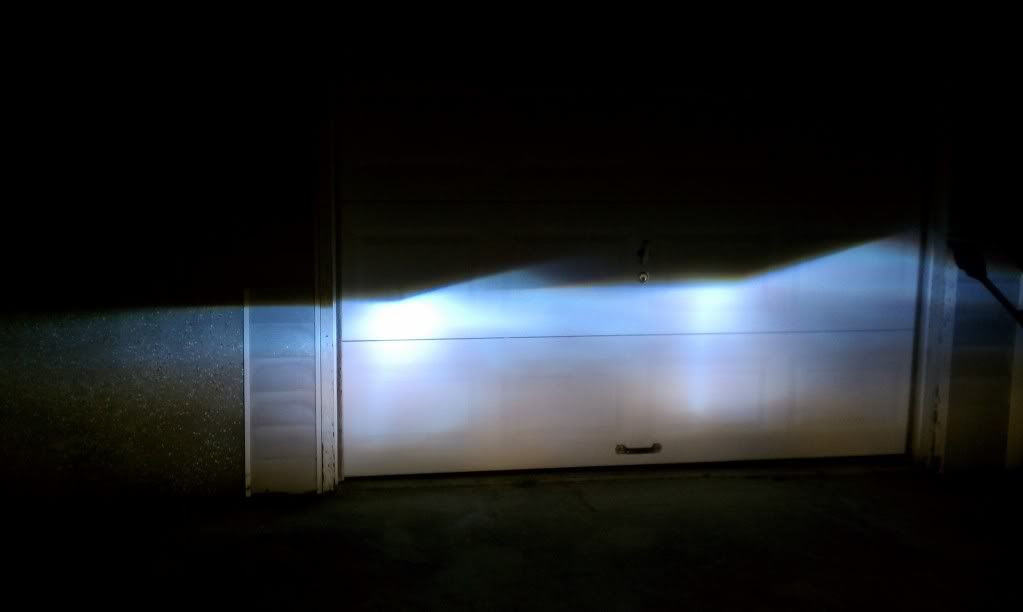

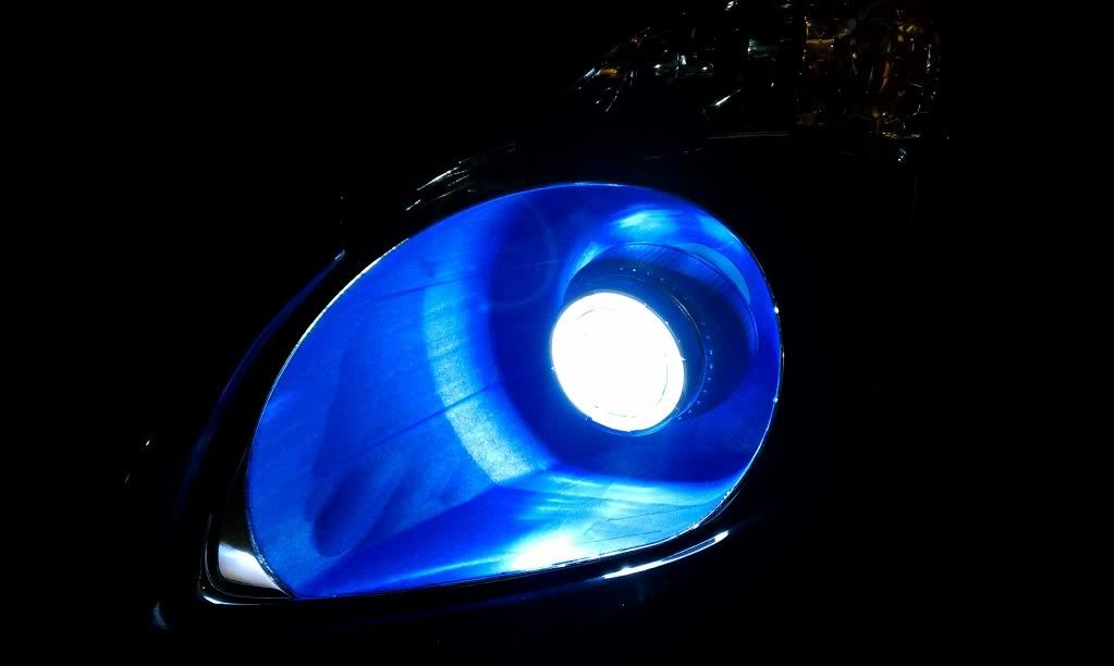

This was the remainder of my work from last night. I went a little too far the other way and now the horizontal line is a little tilted but it's easier to adjust it now. Here is the new position on the right side:
This is with the bowl just taped up, and not yet painted.
As you can see, much less light is being wasted by bouncing around inside the bowl as it leaves the projector. Perhaps this tip of painting the bowls could be added to the how-tos.

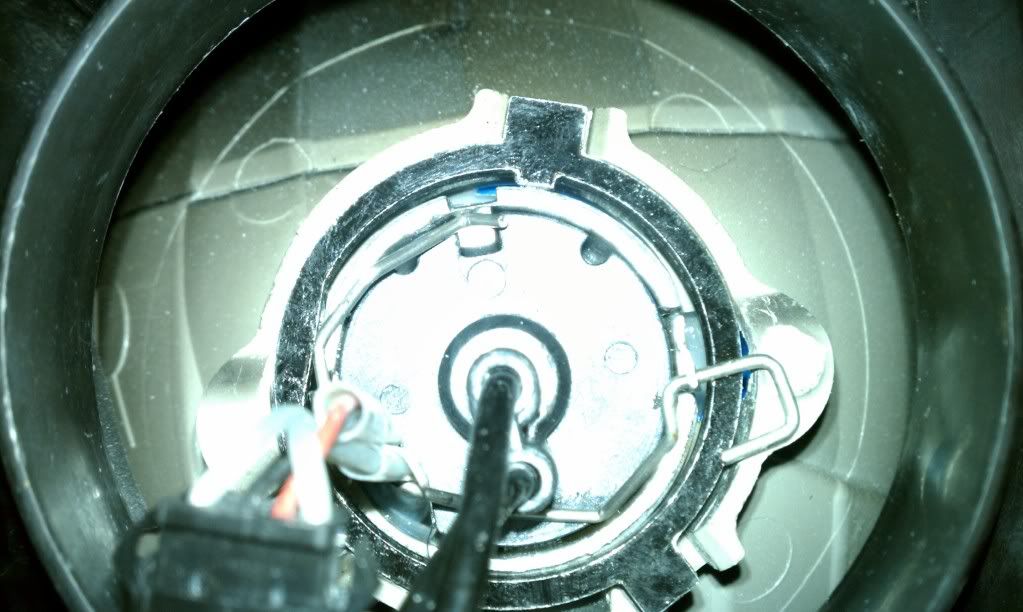

This is the culprit for my initial 'RHD' looking cutoffs. Notice the locking washer has a tab that is suppose to line up with the indentation on the projector itself. I lined these up in order to squeeze enough threads through the hole and crank down on the nut. The fact of the matter is, when you line the slot and tab up, the result is the different cut off since the projector will sit in the bowl slightly crooked by about 15 degrees. Unfortunately, if you do not line the tab and slot up, you can't push enough threads through and get the tightening nut securely on. My solution was to ditch the locking washer and just use the tightening nut to keep things secure. As a result, there are now plenty of threads to crank down and secure the projector in the bowl without much frustration.

HOLY. CRAP.
It's an entirely different LEAGUE of brightness!! I can see for what feels like MILES!! Decided against paint tonight since it never got out of the low 50s today and it had been cloudy all afternoon and threatening rain. I did get the second bowl taped up, and have the projectors in perfectly horizontal and with cutoffs in their proper locations. Also aimed them vertically and it is just incredible how much light was being wasted bouncing around in the reflectors and shooting up into the air with the incorrect cutoffs. THIS was the kind of light on the road I was hoping for at the beginning of this project.

You can totally see in your pics where the.light will bounce.off the buckets if you don't paint them....the yaris is a super deep headlight..

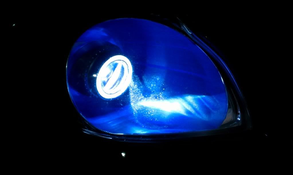

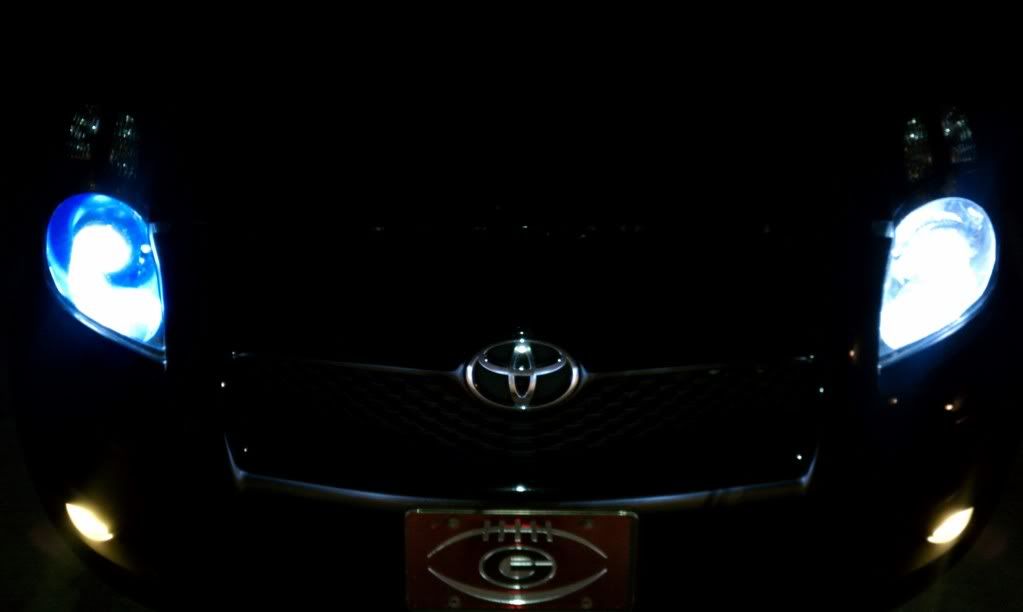

BAM. All done. Painted, legal, and thoroughly awesome.
The ONLY quibble I still have is maybe going 5K instead of 6K. It's a touch too blue at times for my case, such as in the rain at night. Which it seems to do often here lately. Otherwise, I'm happy I stuck with them and worked out all the kinks. I was a gnat's whisker from taking Garm up on returning them.
