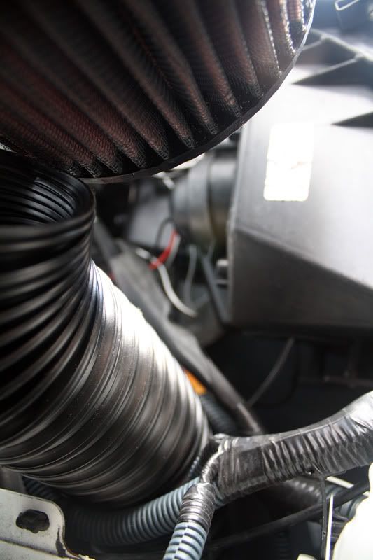

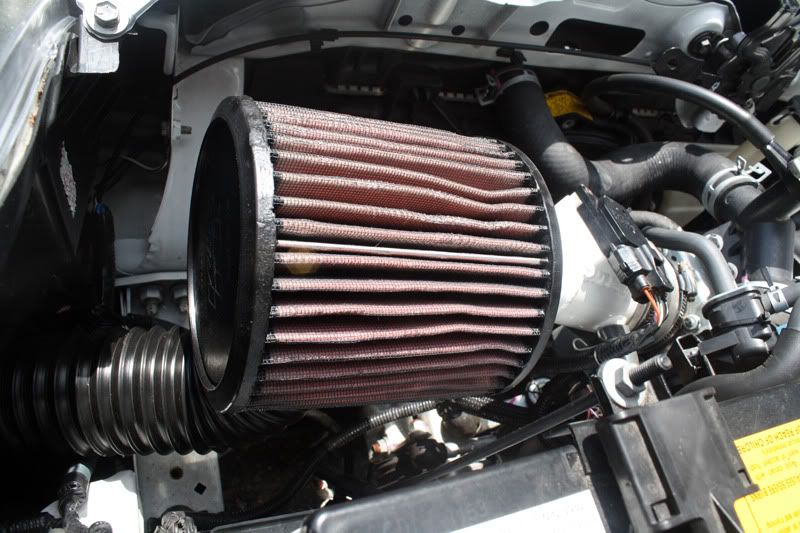

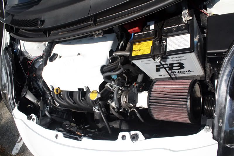

Another intake set up
Modified weapon-R intake (cut down by 2 inches or so)
ceramic/paint coated pipe with a k&n filter
flex tube run from the fog light housing to the filter
corolla TB with swapped chip (thanks to whooopppeee)

how is that hose held on by, zipties? Sufficient air getting to the filter?
Its a nice setup, just curious....i cut slits on my fog light cover like yours and covered w/ mesh behind it..

it actually is held in place by its own size barely fitting threw the passage available lol

With the tb yes and the direct air def keeps the intake temp within 4-8 degrees of actual outside temp
What I'm trying to say is my car is basicly a rocket ship now

Did you get any weird stuff from the TB swap? I have some oscillation but I'm OK with it. Also revs are a bit high on cold starts...

we switched the chip sets when we did it. at first there was an oscillation but then it went away. high revs for like the first 5 or 10 seconds then doesn't happen again.

Sounds like you set the tb up right , thats how mine is running now . I'm feeling the white engine cover and intake, they looks good
