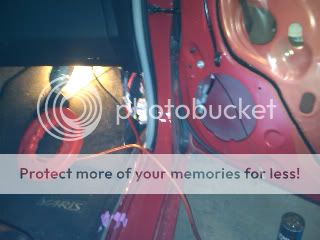

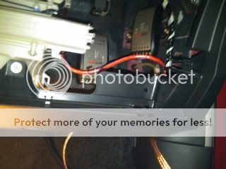

I've been running polk components in the back of my 08 HB. I finally got the other pair for the front. I've seen people mount the tweeters at the top of the door. After trying different places, they did sound good there. Pulling wire through the boot in the door was a pain until I greased up the wire puller.
After mounting the mids, which actually cleared the window with fatmat behind the speaker bracket, and mounting the crossovers behind the glovebox,

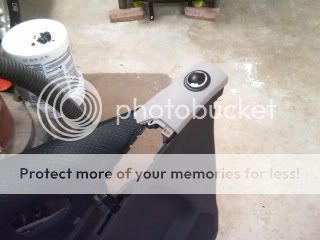

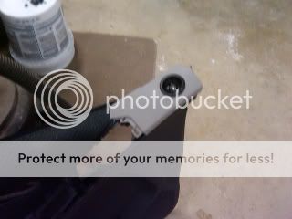

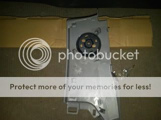

I drilled the holes for the tweeters

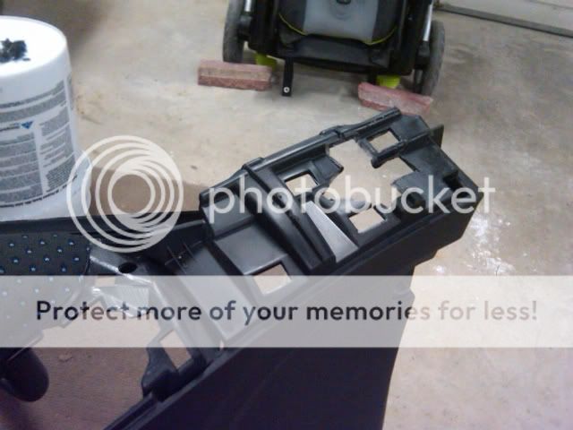

The panel under it looked like this when I started

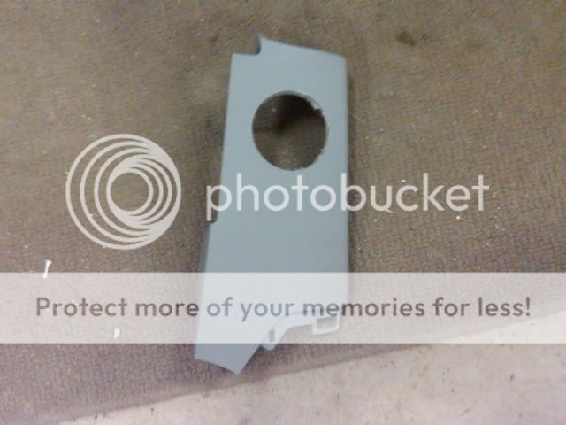

and this when I got done modifying it

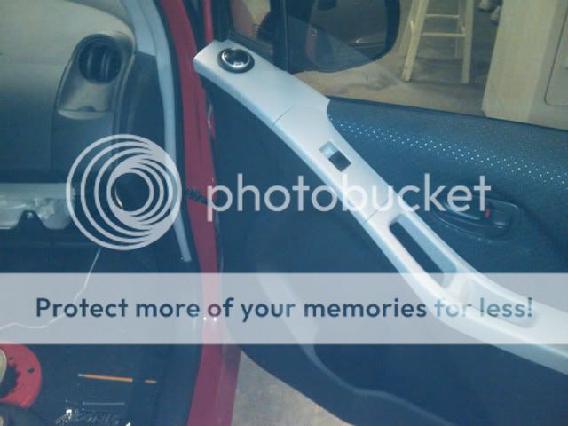

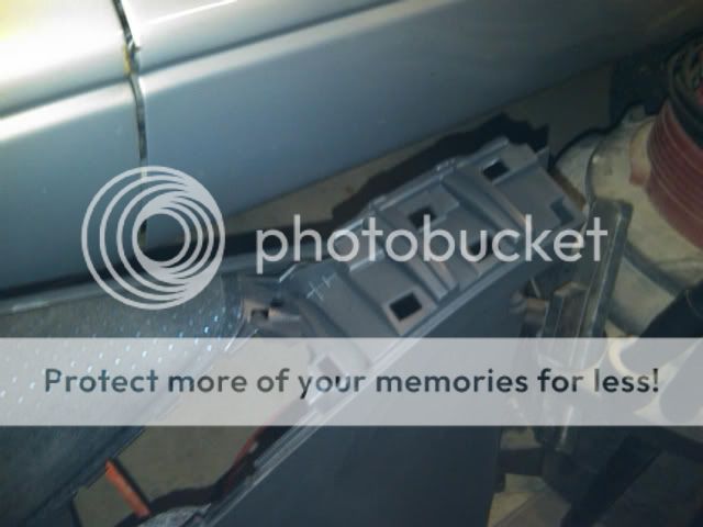

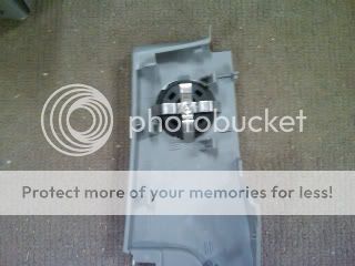

I mounted the brackets for the tweeters
and put everything back together
They do sound good here, and they're protected a little from the rain if the window is down. Next step will be to deaden the doors when I can get more mat and then a custom box in the back. Right now I'm running two 12" sony's that are about 6 years old. Sorry for the crappy photos. I had to use my phone.
