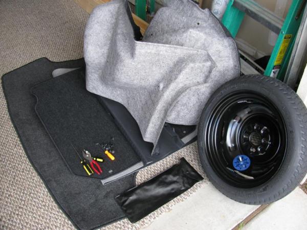

Removal of the trunk "stuff". When was the last time you checked the air pressure in your spare?.

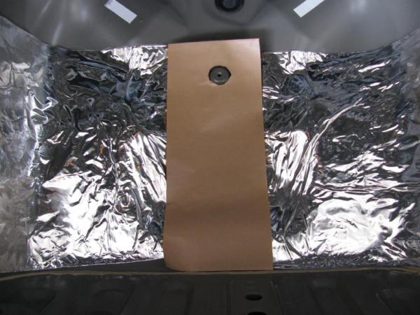

I used the leftover backing for template material.

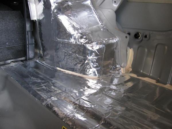

Pretty much done with the trunk. This is the drivers side. I may have to put some foam over the vent to dampen the sound, but still allow air movement.
Trunk, passenger side.

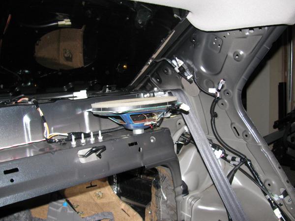

Right rear "C" pillar panel removed. Notice the stock speaker sitting there...where's the magnet?!? Ohhhh! There it is! Look really close..!
