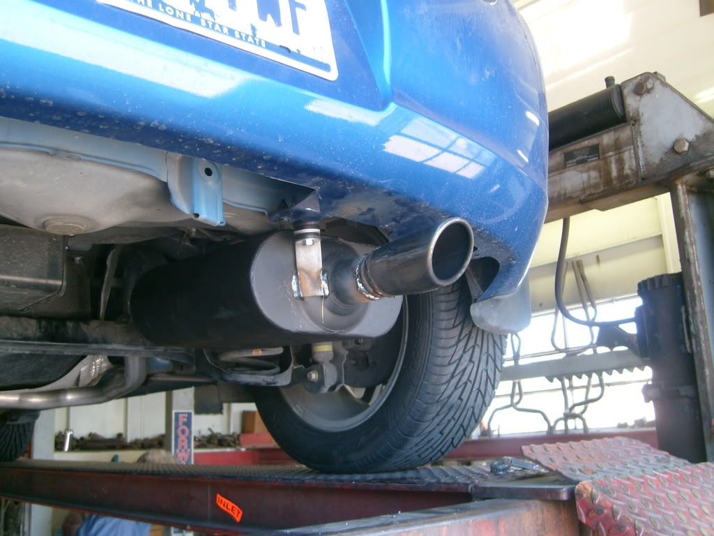

the stock resonator on the yaris is fed by a 2'' inlet/outlet resonator. The piping ahead of the res is 2'', but behind it it drops to like 1 3/4'' or something, that's why I went 2'' on from my res back to the 60 which was a 2'' inlet/outlet as well :)

60 series
straight pipe
make sure when you're having your 60 installed, try to find a better mount point than my muffler guy did, I had to go back and fix it up later. A little more time in planning makes for a better placement, cuz it's a tight fit in there, especially when lowered on df210's

thanks for the pics! i was hoping i could use the center inlet offset outlet 2in style and fit it in like this one...http://www.yarisworld.com/forums/sho...hp?t=9520...do you think it would fit?
