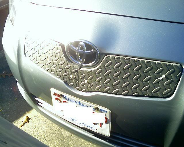

Check it out guys... Whatcha think should I do the bottom aswell?

better than some I've seen, nice job

Nice!...I just went with the cheap and easy and used black duct tape. Of course, the sedan's top opening isn't as large as the hatch's so it was easier to just use the tape.

Materials I used were as follows. This floor matt type thing that is foam like and plastic zip ties.. Had both at work. Free. So should I do the bottom opening aswell? I was thinking I'll wait till it gets really cold. See how it goes with this setup for now.

I wouldn't do the bottom unless you've got a scangauge so you can keep an eye on your engine temps. Wouldn't want to damage the car

+1, are you running this currently? Keep an extra close eye on your temp.

I am using it currently. Just made it yesterday. It's been getting cold!

i drove my yaris all winter last year with no block and had no problems at all. keep in mind that im in north central wisconsin. it gets pretty cold here and had no problems with it at all.

You shouldn't have any problems. The point of the grill block is to make the engine warm up faster and stay warmer. I'm sure BailOut can give you the numbers, but in theory it should help improve your fuel economy in the winter months.

man if you would have found some way to tie it without the zips it would look pretty sick.

Looks Real Nice!
Great job, looks very professional.
Someone mentioned in a previous post, to loose the zip-ties. I used Velcro to fasten my block. Makes it real easy to remove in the summer or on the rare hot winter days....push-on & rip-off!
