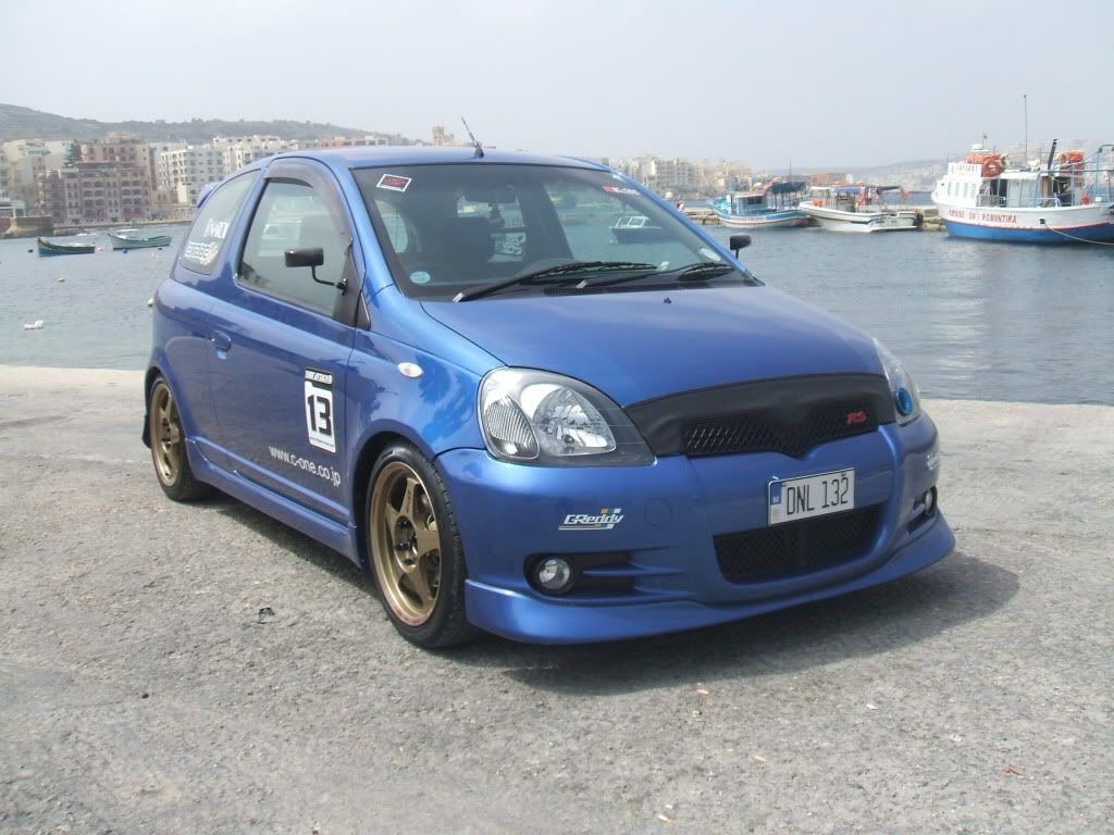

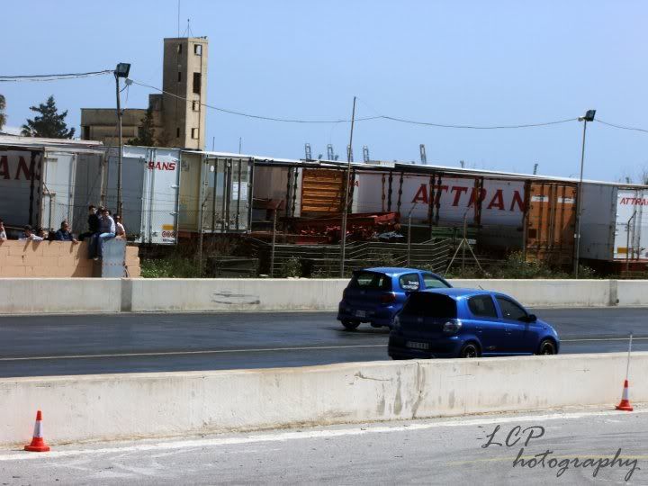

The header was made here in Malta by ZISCO.. He took the exact measurments etc... Well regarding the itbs i would like to know wether kekropas did fit them on standard cams or not!!? I think that it would be a great mod since at the moment i've only got the 4-2-1 header and a good induction kit!!.. I just drag raced a yaris turbo and his time was 16.3sec and mine was 16.7sec:) Btw this is my baby vitz...
The custom made air duct...
At the Malta Drag Race Track...
