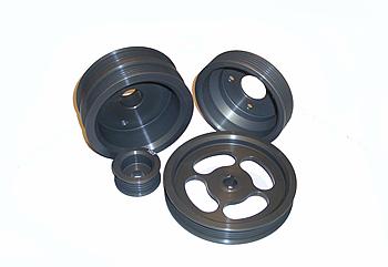

i'd like to do this mod, but i'd like to know if there are any cons to this type of mod. does anything get worn out from changing pulleys? changing pulleys changes the cam timing right? how hard is the install? i know theres a diy guide for iton here somewhere i jus want a straight answer from someone who has done it.

so i read every lil facet about pulleys on nst's website and these lite pulleys are the same diameter as the oem pulleys so they dont change timing in any way, right? its because they dont weigh as much as the oem pulley that makes better use of the engines output. am i right?

size size just lighter, so less rotational mass = better MPG and more HP transfered to the ground because less is being waisted trying to sping the hevier pulley

Crank Pulleys and accessory pulleys have nothing to do with cam timing, whether they be underdrive, overdrive, or simply light weight variants. The concept is in regards to the rotating assembly and the transfer of horsepower between the crank shaft and the accessories which translate this horsepower into the services they provide. ie the alternator, a/c, etc.
Adjustable Cam Gears, also called cam pulleys by some, are directly attached to the camshafts and allow the individual tuner to change the timing of the camshafts, thereby changing the powerband of the engine. Adjustable cam gears are usually used in conjunction with aggressive aftermarket camshafts and wouldn't do much for mildly modified engines.

I got my pulley on today, and there is a nice bump in low-to-midrange. Can't feel much when winding it up, but that's fine.
My only tiny gripe about this pulley is the timing notch is too small, barely there really. Won't matter much until smog time, though, since the car tunes itself. Overall, VERY nice product.

are the other two pulleys available yet?

They are being researched as we speak. Look for the GB coming soon!

Start looking under your couch cushions, in your ashtrays, and old jean pockets boys and girls. New pulleys are a comin!
