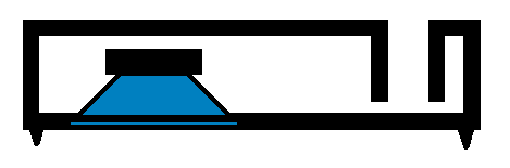

is this for a hatch or sedan?
You can build a slim box like 4" thick for the trunk or hatch and you will not lose much space at all. With the HATCH put the subs to the backs of the seat. Angle the box the same as the rear seats and make the back if the box strait. this will take up about 5" or so at the most. Also if you want you can slide the rear seats up one notch or two and that will give you an extra inch or two to play will and take away an inch or two less from the rear that you would have lost.
For the sedan make a stealth floor box. Have the subs fire down. This way you can pile anything you want on the box and not hurt anything, basicaly it will bring the trunk floor up 6" for a loss of trunk depth only, not enough to even make a difference in most cases.
mount the amp under the passenger seat.
