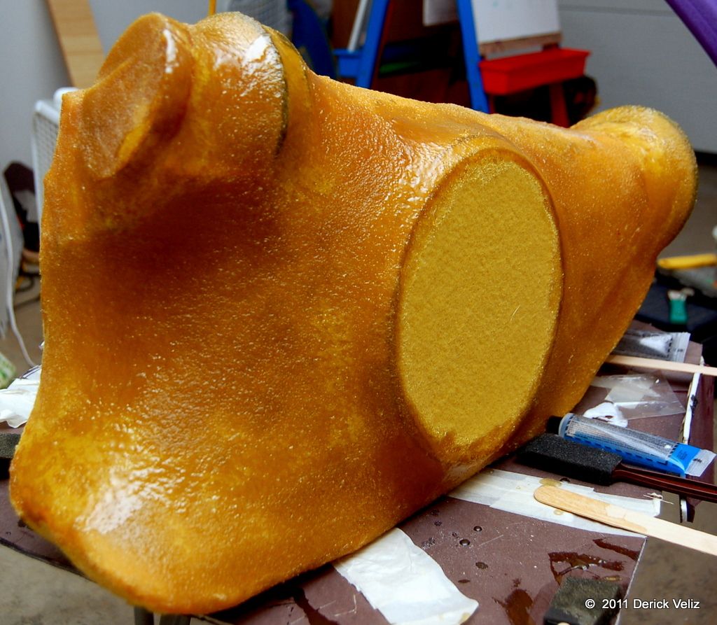

I wish it was about the resin to dry, that's not the issue...
12 Years ago, all this install would be a 3 or 4 weeks and done, I used to do projects in less than 1/2 the time the average person would take but...
Now with 2 kids, a house to take care, 2 jobs and 200 miles/day of commute it's a little harder to get to my stuff. You will get to that point in your life, I know others here know what I mean. It's all good like I said before: "I would love to have 30 or 40 hours/day and very little sleep (o:
Patience I'll get it done sooner or later (o: It's me who really wants to get all these done!

Oh, as for reinforcement...you can keep laying mat down OR you can use long hair to reinforce.

long strand fiberglass filler
http://www.boatbandit.com/evercoat-k...ler-12150.aspx
The nice thing about the longstrand is that it's a lot like a thick (fiberglass reinforced) bondo. You can put gloves on and form it on the inside of the enclosure.
I'm also watching some of the "advice" the DIYMA guys are giving. Be careful with that. Most of them are keyboard commandos. Yes, you can lay down three layers of matting on top of the resined mat you have down BUT you risk becoming too dry. And this guy saying to do that based off a picture is full of shit. He needs to be there to put his hands on it before ANY advice is doled out on how you're doing your glass.
He's trying to hook you into thinking he's a glassing master.

Thanks, for the EVERCOAT Kitty Hair Fiberglass Filler. Looks like this will be a good cubic feet volume killer if I need to reduce the size of the enclosure!
Yeah! I hear you about the glassing master, I take step by step and easy going, read and think twice!. Thanks again.

The DIYMA guy talking about "biaxial" mat? That's chop mat. Take a close look at the mat you have, notice that it probably has two layers a top an bottom...bi axial...hmmm.
When we're talking about strength, it's about the resin quality, the amount of resin, and the material used. Can you say carbon fiber weave? THAT is strong. Why do you think they use it on race cars. Strength and light weight.

Yeah, that's ok, I'm building this small little box just for the fun, hopefully it will be a keeper, and I'm aware of strength and light weight I agree with you, I'm used to try to make it as strong as possible but keep it very light! some of my airplanes are made of carbon fiber, wings and fuselage!
This little plane over here buzzes at 140mph speed passes at 4' off the deck:

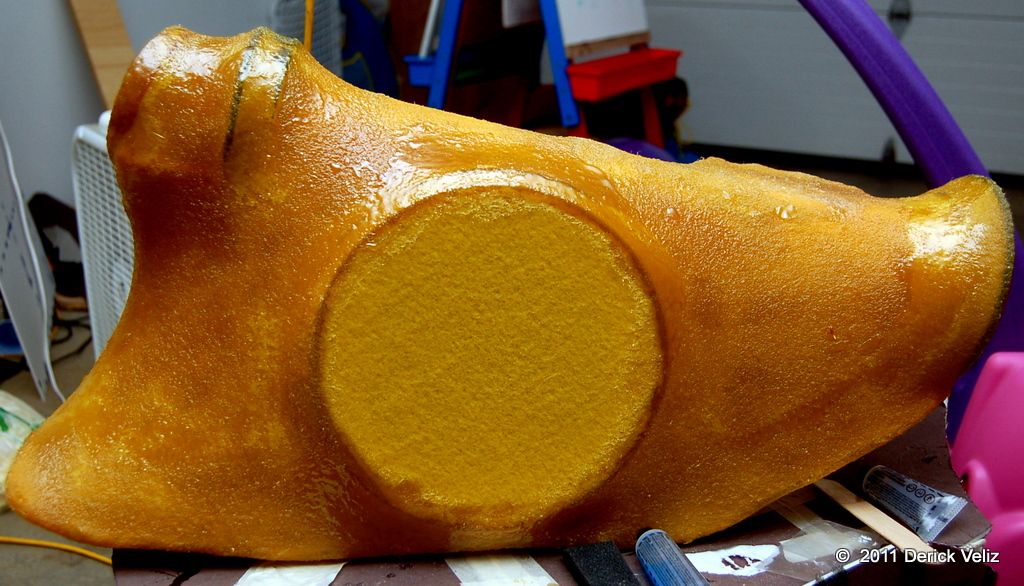

Now with the I6SW:
This one is not going to "MUTE" no way, I finish the enclosure so I could try and play with it, (so it's not completely finished)
It's late so I didn't crank it up, I did have to move some settings in my HU like time alignment and bump up the db a little bit, even with a new woofer and at low volume hits very nice, goes low and merges very well with the LOWS, so let me play with it for 20-30 hours (break in period) and will update about it, so far at low volume sounds very positive, we'll see with more watts, volume, road noise, etc... how responds! (just for the record I have a big smile on my face )
I was at my sisters place and I did not resist to take a picture [with my cell phone!]
D.
