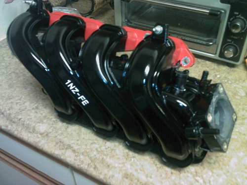

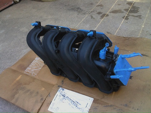

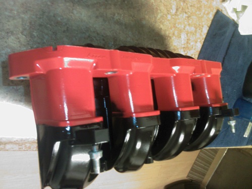

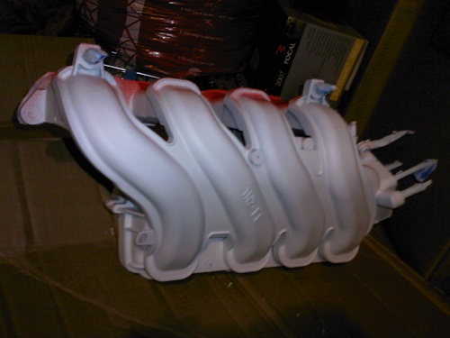

I made my own spacer. it was a pain, but it turned out awesome and it was fun! (no longer hoses required)
http://www.yarisworld.com/forums/showthread.php?t=55767
http://www.yarisworld.com/forums/showthread.php?t=56265
and you should port your manifold. or you can buy mine in April when I sell it.
http://www.yarisworld.com/forums/pic...pictureid=6102
http://www.yarisworld.com/forums/alb...pictureid=6101
http://www.yarisworld.com/forums/pic...pictureid=6100
http://www.yarisworld.com/forums/pic...pictureid=6103
http://www.yarisworld.com/forums/pic...pictureid=6104
http://www.yarisworld.com/forums/pic...pictureid=6105
http://www.yarisworld.com/forums/pic...pictureid=6107
