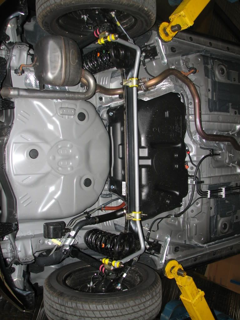

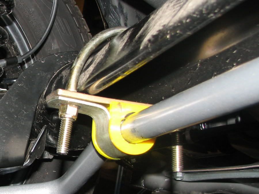

sorry about the delay...I've been tied up for the last few weeks. Whiteline already has a non adjustable bar for the rear of the Yaris so I got them to take a picture of how they are mounting it.
To make this adjustable we would convert the ends to a vertical blade, and the link would be a pin top and eyelit lower.
Here are the pix:
Please let me know if you have any other questions.

That's much less elegant than the TRD design. It's also exactly the same setup we put on my friend's Sentra. Not pretty, but effective.

Wouldnt this be more effective than the trd swaybar. It looks like it allows for the torsion bar to twist more. As opposed to the trd one that just stiffins it up more. Or perhaps they could be used together? Or would that be overkill

The whole point of either the TRD or the Whiteline design IS to make the rear torsion bar resist flex more. If they both use the same bar diameter, then they're going to both give similar results. They're about the same shape with about the same leverage points. The TRD bar may actually react quicker because it's not mounted in rubber (poly, whatever) bushings.
Here's a tip for you guys: Don't buy parts just for the sake of buying them. Buy parts to solve problems. The Yaris is a FWD car, like most FWD cars, it has the tendency to understeer and/or spin the inside front wheel when you try to accelerate through a turn. This is the problem you're trying to address with a rear bar. If you go too far with that, then you end up with a car that goes tail out in a turn, which is NOT something you want on a street car.
The TRD bar does a pretty good job of mitigating much of the understeer in a Yaris. While you probably COULD install both the TRD and the Whiteline bars at the same time, yes, it would be severe overkill. The car wouldn't understeer... but it would be dangerously tail-happy.
If anyone feels they need more rear bar than a TRD bar, they'd do better to duplicate that design with a slightly fatter bar (like 1-2mm larger diameter). Personally, I just opted for stiffer rear springs. It was a lot easier to do.

The TRD is a better design, and if bar size is equal will be more effective. The arms of the bar are longer as well, essentially making the bar softer. With sticky tires and stiff springs I could easily see the endlink mounts getting bent. Plus they are mounted via a single bolt.
Like Loren said, if you need more rotation than the TRD bar, a better bet is stiffer rear springs.

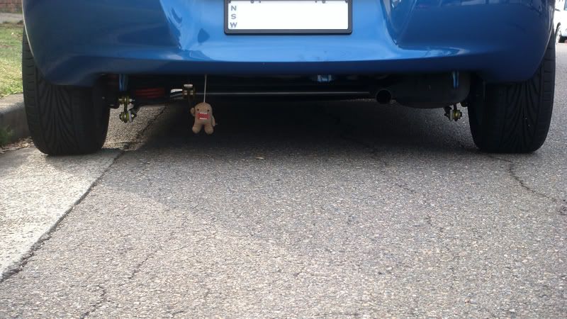

I got one of these Whiteline adjustable rear sway bars installed yesterday. The car handles much better. It feels more planted on the ground when going around corners. I currently have it on the softer setting..
In my little sister's own words: "The car feels like it's stuck to the ground".
Installed.
The design is quite ugly, but it does the job! It's the cheapest rear sway bar available (to people Down Under), and being adjustable is also a bonus! :P
