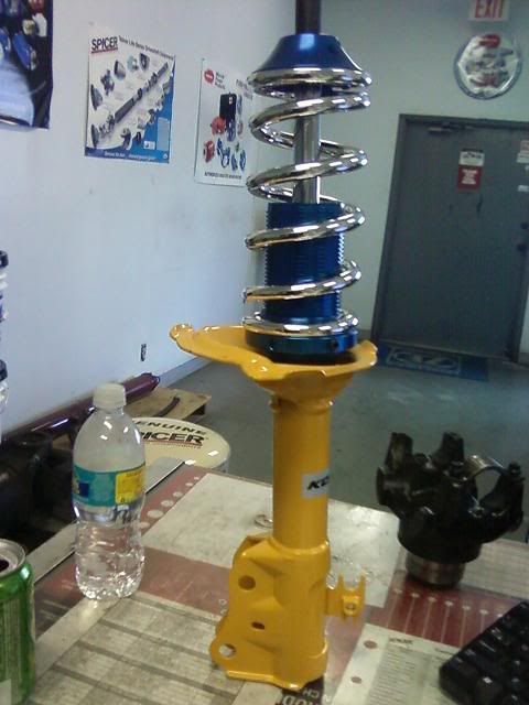

Posts: 4,927
my front parts are here! gotta get back to jury duty :( but here's a teaser pic

Originally Posted by Loren View Post

Seriously, it looks good. I know the cool contrasting colors and chrome are just incidental. Can't wait to hear how it works for you.
What rate are those springs? They look pretty stiff.

Posts: 4,927
400lb springs. i'm afraid they're too tall, by the math the car will be sitting higher than stock. i'll be modifying the upper perches to accept the koni strut rods.
just got pulled for jury duty so i won't have much time to work on this til much later :( ahhh irony..
