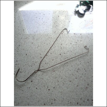

~ 1 old pair of tongs or do like I did and use a hanger I had leftover from the drycleaner

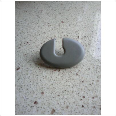

I chose to dye a small part for the DIY so that it was easier to work with and show how easy it is. The visor cover was a great small part for this job

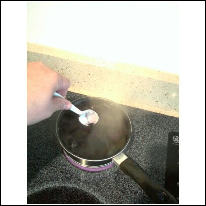

Step three -- Now that you have everything ready to go, you need to fill your pot with water and bring it to a boil. Make sure not to overfill the pot as we do not want the pot to boil over.
Step four -- After you have brought the water to a boil, empty the contents of the package into the boiling water. You may need to lower the heat, but still to a boil in order not to boil over. I only used about a 1/4 of the package, which is plenty enough for these two parts. It would last about 50 parts in the long run, so a package can go a long way. Use your plastic spoon or old spoon to stir in the powder.

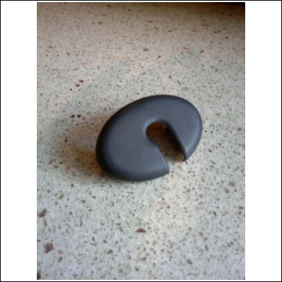

Step five -- Place the items in the boiling water. Use your tongs or homemade tongs like the ones below to place them in the water and to check them during the process. The longer you allow them to boil, the darker the color will become. Check on them after 2 minutes to see how the color is coming along. You may not notice it right away, but after about 10 minutes in the boiling water, the part/parts have pretty much turned the desired black we are looking for, close enough to match with the rest of the interior trim.
Step six -- Remove your parts from the boiling water and place on a paper towel. Turn off the boiling water and proceed to run your parts under cold water. Without going into details of how and why this should be done, here is the Cliff Notes version.....Molecules -- heating something makes them expand and cooling them makes them contract. It's better for the plastic and the dye, lol.
Step seven -- Your part/parts have undergone the nip/tuck of all DIY's at a low cost, and looks awesome.

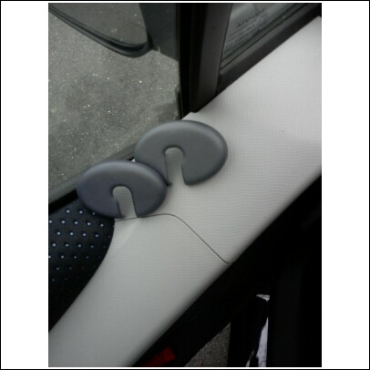

Step eight -- Take your newly dyed part/parts back out to your car and see the dramatic difference you've been able to create with just a few bucks, rather that spending hundreds and hundreds of dollars to buy new interior pieces. This photo shows you just how well the dye takes to the plastic.

It will not run or bleed as it is perm. It's pretty much the same way as if it were done at the factory, just instead of adding the dye during the manufacturing process, I've added it after. Still, will not come off as it is now part of the plastic.
