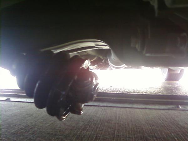

I've done lowering springs before, no problems. Well today I lowered my car, finished it all up, and then got in the car and turned the key. Put it in drive and heard *SQRREEEECH* I was like oh no! So I immediatly turned car off. Jacked it up, and my axle was popped out of the transmission. I broke a bearing and it popped out. It was never in the all way. Do I have to buy a whole new axle? Or can I just get that bearing that was on one of the 3 tips of the drive shaft? I'm refering to the shaft that goes into the transmission... Whats that called anyway? Axle or driveshaft? or what? So yeh big mess. Could be extremely costly for me right now I am not happy with myself. Lowering springs gone wrong!

When I put my springs/struts on, the axle got pulled out a bit. I just fussed with it and got it back in.
How do you know you messed up the bearing?
(Where in Oregon are you, by the way?)
corvallis, OSU.
So uh turns out I can't just get the bearing im going to have to find a whole axle...

ok i took pictures!
wholenizz is offline   Reply With Quote
Old 03-22-2010, 08:04 PM   #16
wholenizz
wholenizz's Avatar
Drives: 07 yaris hatchy
Location: OREGON
Posts: 127
I have a spare stock axle -- left or right side?
I just need the needle bearing off of it :[ check the picture I guess it's the half shaft? not the actual axle? :wu
