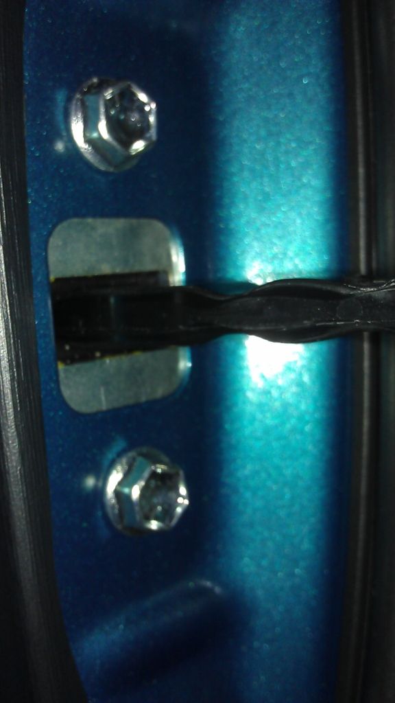

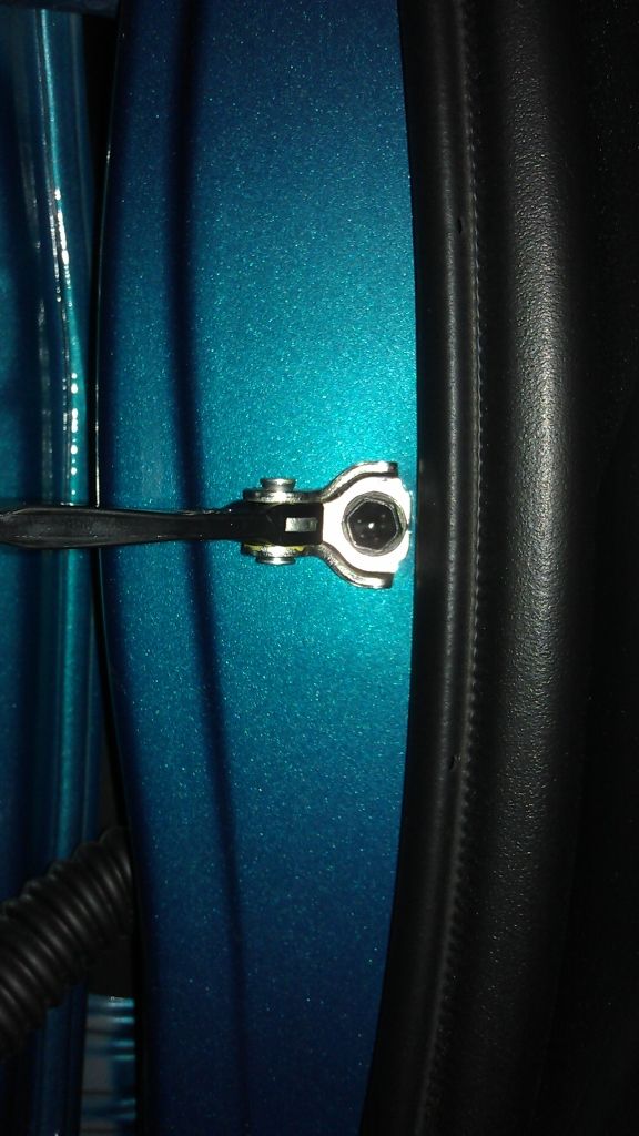

can someone take a pic of the bolts?
ok, so the yaris actually has one bolt on the body side:
and two bolts on the door side:
