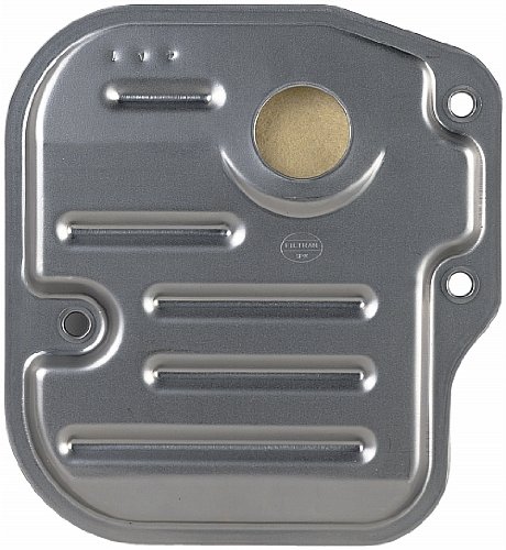

Posts: 197
Originally Posted by Rutherford View Post
I have been told that the filter is nothing more than a screen
Not true:
jack black is offline   Reply With Quote

Posts: 20
I bet mine does not look that good. You just want to see an old man with gravel up his %%$ Well at least spring is trying to get here and I don't have to shovel snow to get-r-done
